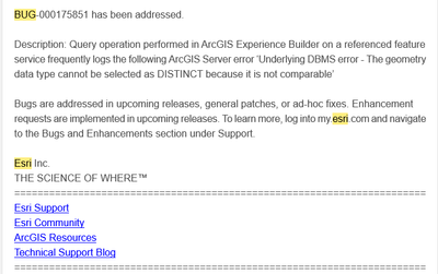

JordanCarmona
How did this shake out? We have this same issue but our feature class (registered with ArcGIS Online) is not based from any views. As far as I can tell it is just being used in an ExB with standard widgets.
TommyJackson
The only performance issue that I see seems to be cluttering of the logs. In my case it seems to be dashboards using the Table Type of Grouped Values that triggers it.
