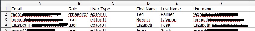

I grabbed the csv template from my Portal (10.9.1) which has this (in Notepad++ for reference):
Email,Role,User Type,First Name,Last Name,Username

My csv file ends up with:
Portal throws this:
viewer/viewer works (if I drop the UT), where is a list of the correctly spelled/capitalized/etc. strings for Role and User Type? I'm tired of trying to guess.
Solved! Go to Solution.
You can just use the User Types as listed in your Org Licenses section. "Creator", "Editor", "Mobile Worker", and "Viewer" for example.

Bah. I flipped the user and role fields in my head (matching the order on the screen, not in the csv). In my defense, I did have to remove the UT portion of the string the help doc said it needed...
