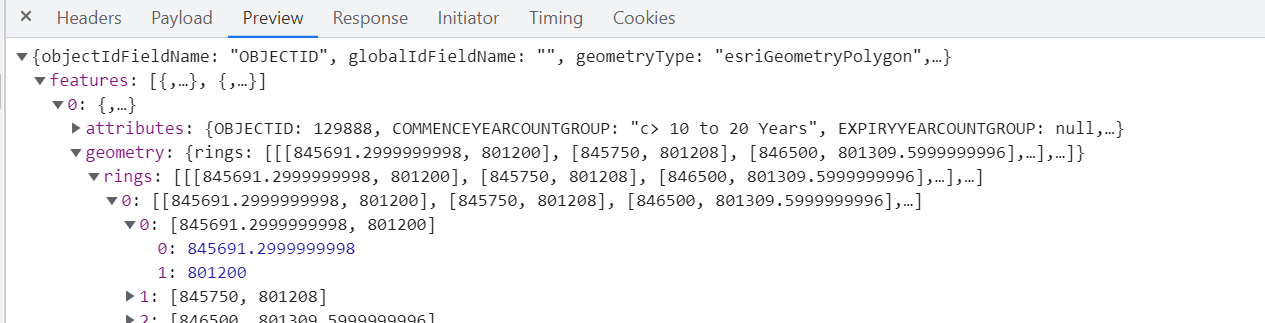

We shared a web feature layer that references registered data to ArcGIS Enterprise and added the feature layer to a web map (view in Map Viewer Classic). However, it seems that no coordinate quantization is applied. The query returned are the absolute coordinates of the geometry.
I have checked that the supportsCoordinatesQuantization is true from the URL of my feature service.
May I know how can I enable the coordinates quantization in ArcGIS Enterprise Portal 10.7.1? Is coordinates quantization supported in the web feature layer that references registered data? Thanks!
