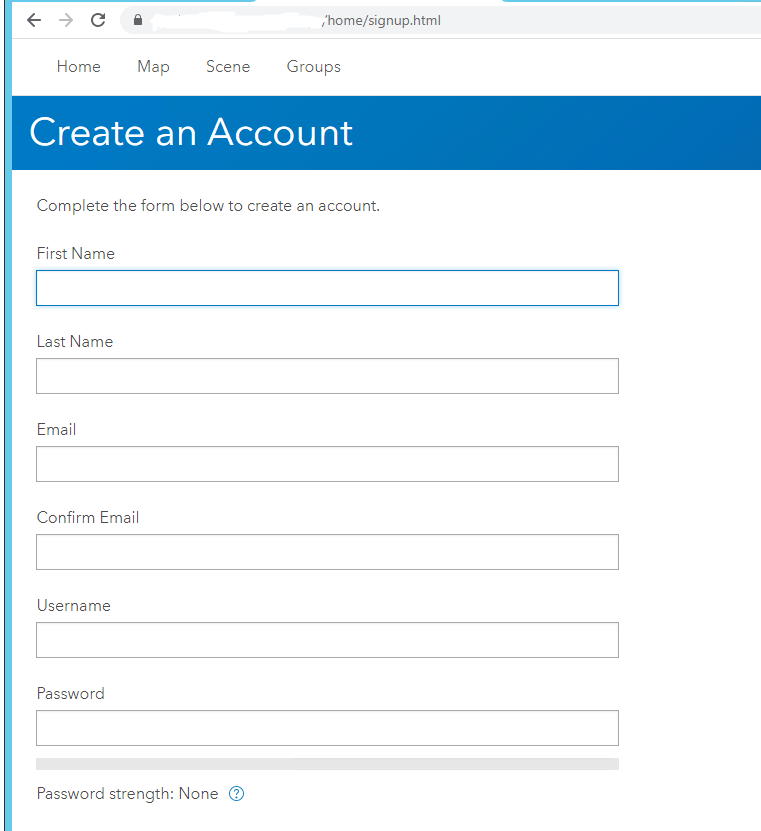

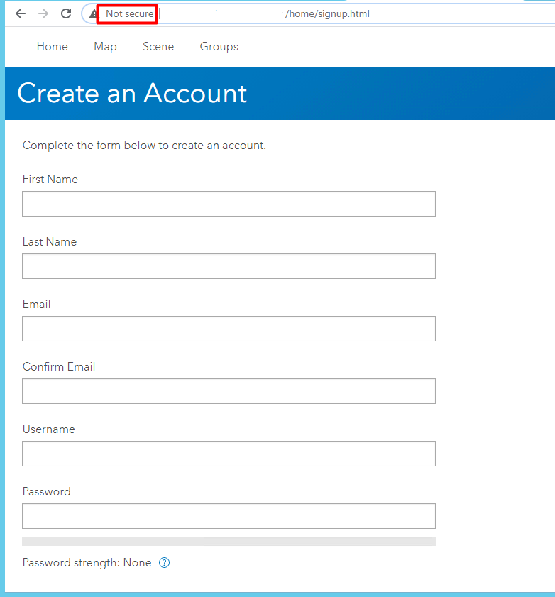

How to make sure Create an Account page are access through HTTPS only when disable Allow anonymous access to your portal .
This only happen when use same network or access through VPN. If I access the page through outside network, it will redirect to HTTPS protocol.
Anonymous Access Setting
Disable anonymous Access
Enable anonymous Access
Setting > Security
IzzatunnasiriIslamABRahman_0-1615286358035.pngIzzatunnasiriIslamABRahman_1-1615286358038.png

Izzat
by
Yes.. Allow access to the portal through HTTPS only check box is checked
