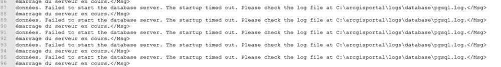

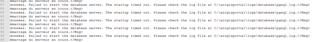

However, we're experiencing now a strange behaviour, our logs are kinda "scary" :
ArcGIS portal seems trying to start (or restart ?) the portal internal database every 5 minutes. I would like to point out that the Portal is functionnal.

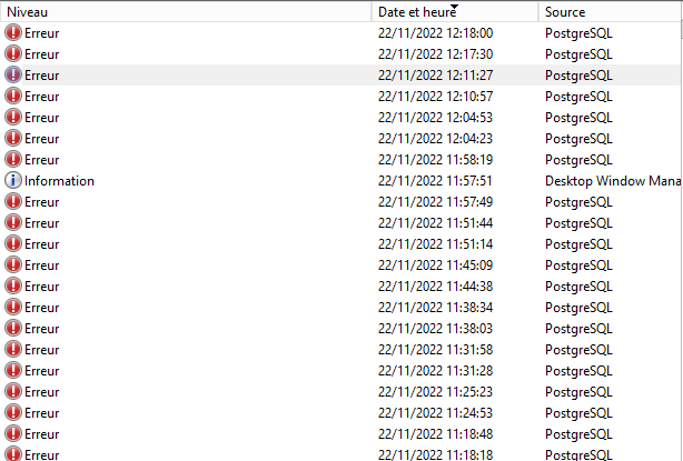

I checked the windows event manager and....
There is 2 message per try :
- pg_ctl : another server might be running; trying to start...
- pg_ctl : pg_ctl could not open log file logfile "C:\arcgisportal\logs\database\pgsql.log" permission denied
