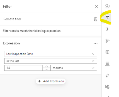

MarcoPoetsch
Hmm, in this case I think I would use the filter option in the web map to exclude all inspections older 14 months.
This is what I usual do to separate features based on date. If the inspections >14months are still important (for stats or whatever) you could make a copy of the layer and exclude/modify the filter expression.
JasonCyphers
That was my original plan, but I don't have that "in the last" option for some reason.
I am in Portal 10.8.1; so, I don't know if maybe Map Viewer (Beta) doesn't have that option in this version.  I see it in AGOL, but not in my Portal.
