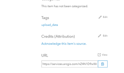

Upload your CSV the first time to create the service
in the new service get the url displayed at the bottom of the page
add /0 if there is only one layer in the service
