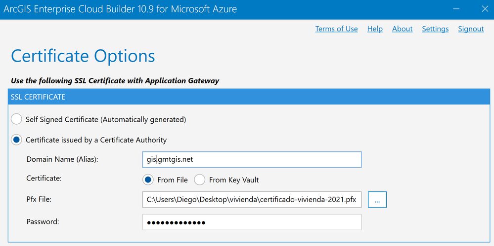

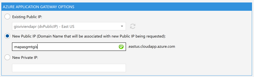

I have my wild card *gmtgis.net and my steps are, i select a public url. Esri support team recommended me to use my subdomain as it is. (gis.gmtgis.net) but in this step, this do not accept any dots before eastus.appcloud.com
I use my wildcard certificate..
I did this, and VM were created and portal and server were running in VMS but URLs  gisgmtgis.eastus.cloudapp.azure.com or gis.gmtgis.net were not working.

ChristopherPawlyszyn
Did you have your CNAME record set prior to starting the deployment, so that gis.gmtgis.net pointed to mapsasgmtgis.eastus.cloudapp.azure.com?
The deployed application gateway is configured with a single hostname, so wouldn't accept traffic from requests using the cloudapp.azure.com alias and would require clients to access the site using the correct DNS entry (gis.gmtgis.net).

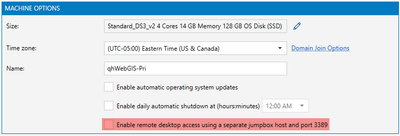

I have seen that new version 10.8.1 or 10.9 activates an extra VM (jumpbox) to connect via remote desktop and then connect to the other VMs (portal, server, datastore, filashare machines). after i am done with deployment, installation and configuration, Can I turn off that machine, right, because that machine do not have anything install from Enterprise on it.

DiegoLlamasOlivares
Hello @ChristopherPawlyszyn  Cname recorded prior deployment worked. Thankyou very much. I would like to know if the extra VM jumbox can be stopped and Enterprise would work fine.

@DiegoLlamasOlivares the ArcGIS Enterprise functionality shouldn't have any dependency on the jumpbox being available so turning it off is fine. There is a separate checkbox you can select during deployment if you would prefer to not provision that separate VM.
