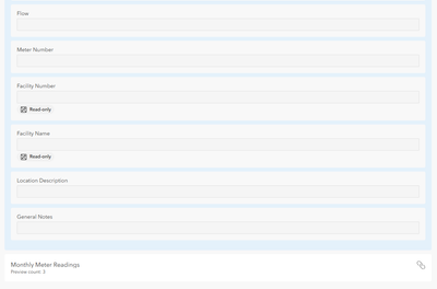

I want to add to this thread a separate but related idea:
What if in the Field Map Designer settings, you could just toggle a button to turn off the blue circle plus-sign in the Field Maps App. This way, users can edit certain fields in the parent point layer but not update geometry (even though that is allowed on the feature service). Then in Field Maps Designer you can setup your form so that the editable parent feature attributes AND the related table records are editable only.
Kind of like this:
