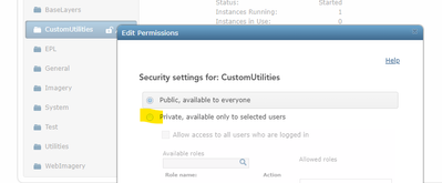

you can set security on folders within ArgGIS Server Manager - is this what you are looking for? You'll have to set up roles and credentials (username and password) for the people you want to have access. There may be an SSO approach to this but I'm not sure if that is implemented in Server Manager or not.
EricEagle
@clt_cabq Interesting, thanks for the tip!  I will take a closer look at that.  We do not set up Enterprise accounts (everything is via LDAP) but as long as we can demonstrate that there is some auth check (e.g., is there a session token) we should be able to open it up to all users.
EricEagle
UPDATE: @clt_cabq So, no this is not what we're looking for.  Our ArcGIS Servers are federated in an Enterprise setup and no such controls exist for that.  We have put in a feature request with Esri but I will leave this idea open just in case other users are interested in giving it a thumbs up.
