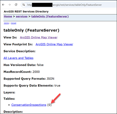

This limitation was relaxed in while publishing from ArcGIS Pro in v3.3.
Please give this a try. On the server side, I don't think you'd need to upgrade unless it is an older or unsupported release.
