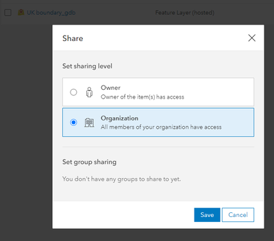

This can be changed via Portal for ArcGIS Security settings. Please see the following:
https://enterprise.arcgis.com/en/portal/latest/administer/windows/configure-security.htm#:~:text=Mem...
I have tested this on 10.9.1 with a creator (Publisher role) and I'm unable to share items publicly:
You still have the option to update to public as an administrator.
