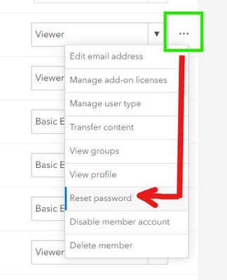

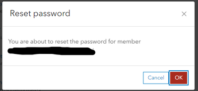

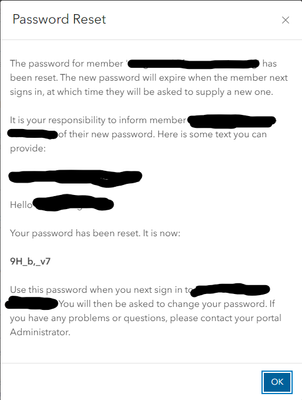

Then in Portal members menu you can 'reset password' for that user and it provides a randomized 8-character temporary password.
I then send a boilerplate email to the user providing a link to the Portal login and their username and temporary password to login for the first time.
Using this method, they are forced to create their own unique password (and security question).

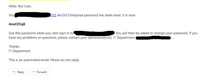

I added a test smtp email account to add to my Portal (11.1 in my case) to see what may change. The behavior DOES change in at least 1 way. Although creation of a new account still requires you to enter a password, when performing the password reset step I mentioned above, as the Admin, you no longer see the popup with temporary password information when resetting a user password.
Instead, the user is directly sent a boilerplate email with login instructions with the temporary password:
I searched around in the Portal Settings but I don't see where this boilerplate email can be customized. In my case, I'm not sure that this is good enough since my users sometimes are being onboarded to our org and have no idea what GIS is and maybe have never even used web maps much. I try to put in some extra information in my emails to new users to give more context to why they are receiving this and what this account is to be used for. For example, we use Portal user store as our single sign-on for Cityworks. I add important context that this account is what is used for Cityworks login, or other secured GIS resources, etc. I often customize the boilerplate email a little bit if I know the user has particular use cases.
