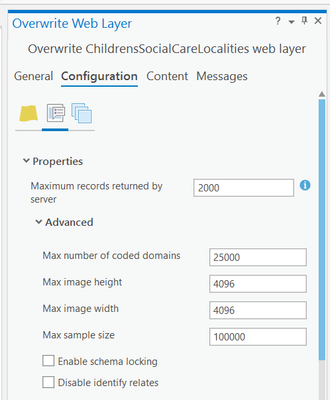

How did you publish your map service ? In ArcGIS Pro you need to make sure enable schema locking isn't ticked
bsanders69
That box you are mentioning, is a potentially dangerous thing based on a conversation with ESRI Support.  It was designed around read-only reference data that will never change.  Certain schema changes can cause services to act erratically if the underlying data structure is changed and service is not turned off and started again to get a push of the correct schema.
GillWare
Interesting, we've been using this for years and not had any problems but will bear in mind.

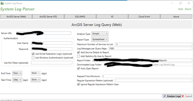

NathanEnge
System Log Parser would give you all the datasources of all your services based on your system logs. Should set your logs to verbose, then get a scan of your system logs, then can set it back to warning.
See screenshot:
SLP looks like this:
Download here:
https://www.arcgis.com/home/item.html?id=90134fb0f1c148a48c65319287dde2f7
