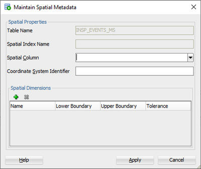

 For what it's worth, I noticed just now that SQL Developer has a tool for entering Spatial Metadata for a given table:
That could be useful.
