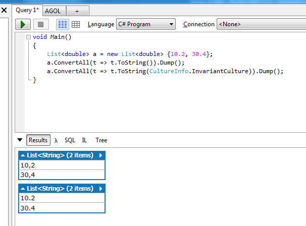

You need to to specify that you do the parsing with the "InvariantCulture" as the "format provider" which uses a "." as decimal separator. Depending on what classes an methods you use for parsing this will look different.
