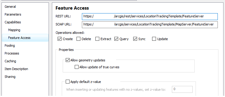

6.  Publish the MXD to ArcGIS Server as a Feature Service
      a.  Configure the feature service with Create, Query, and optionally Sync capabilities.  Sync is only required if you plan to use the Location Tracking service with offline       editing.
      b.  To be able to populate the editor tracking fields with your field crew members you will need to enable token security on your service and add the correct roles. To learn       more about editor tracking go here.
