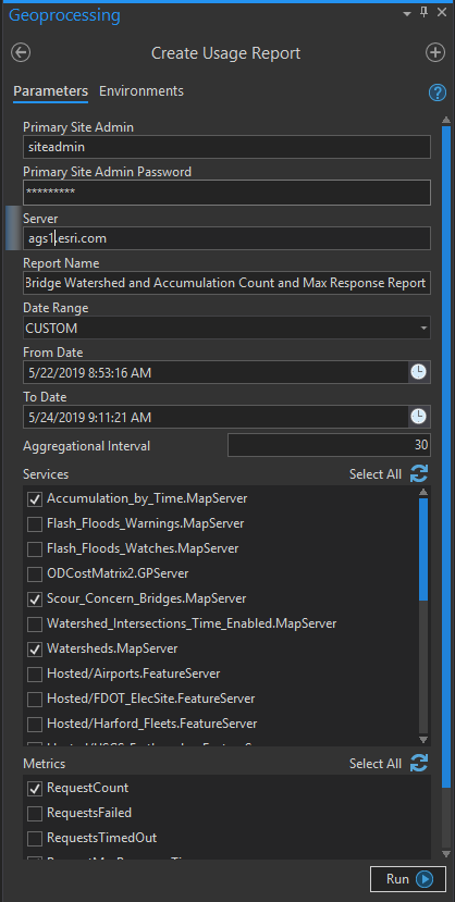

First, you can create a report with the metrics you would like collect, and for which services, using the Create Usage Report tool:
After the report has been created, you can run the Execute Report tool to create a CSV of the statistics:

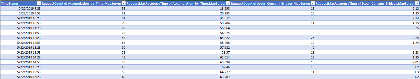

Example output:

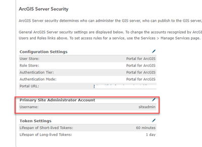

@UalasRohrer  yes, this tool works at 10.8.  Are you authentication using the Primary Site Administrator account?

@berniejconnorsif ArcGIS Server is not federated with Portal for ArcGIS, then you can use any Administrator account.  If ArcGIS Server is federated, then you will need to use the Primary Site Administrator account.

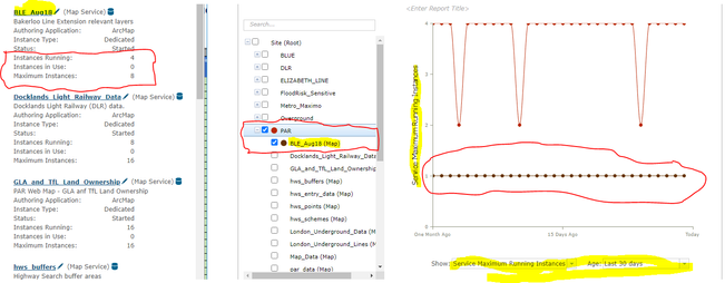

@JakeSkinner Thanks for that. I have managed to work it out and able to generate some reports. I have another question in relation to the usage report if you can make help me.
I have generated a report on Services Max Running Instances for a service, for instance, BLE_Aug18 in the left side of the diagram below (highlighted in Yellow). As you can see, the minimum and maximum instances allocated for this service are 4 and 8. Whereas on the right side of the diagram, the graph shows the max instance running for this service is just 1. Not sure how is that is possible while min instance is set to 4. We have 4 ArcGIS Server running, so does that mean, the max instances showing in the graph is representing for each server? When i generated report for ALL servers or for individual server, it's always returning just 1. If you can make it clear how this works or what could be situation here would be really helpful. I tried to find some help documents in ESRI site, but couldn't find any useful explanation.

@Meghan_CityofDayton can you send a screen shot of the error you are receiving?  Also, are you using the Primary Site Administrator account?  Even if Server is federated with Portal you will want to use the PSA account.
