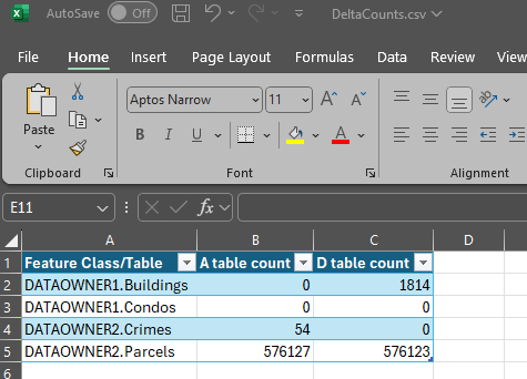

If there are performance issues for feature classes/tables, use the attached tool to create a report for the delta counts of versioned feature classes/tables.  This report can offer valuable insights into whether large delta tables might be impacting the performance.

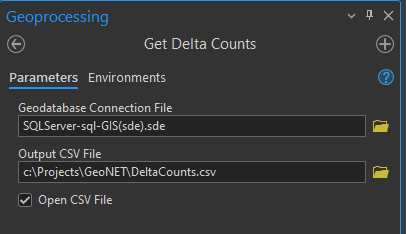

Configuring the tool in ArcGIS Pro:

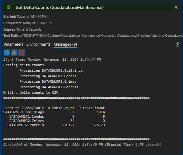

GeoProcessing Results:
CSV Results:
