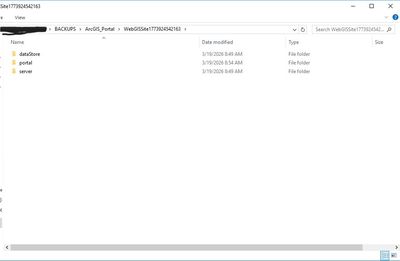

@Izzatcan you send a screen shot of where you have the get-pip.py file in File Explorer?
Izzat
@JakeSkinner ,
This is the location. No Scripts folder.
I try to create manually the folder and run get-pip.py still got same error.

@JakeSkinner  This script has worked great for us, but was wondering if you have an update for the Python for Enterprise 11.5 and higher. In 11.5, webgisdr creates a parent folder with individual folders for dataStore, portal, and server. Because of this the current logic for deleting/moving the FULL backup into the Previous folder does not function.
JakeSkinner
Esri Esteemed Contributor
@DCWade10 at 11.5 the webgisdr should still be creating a single .webgissite file.  Try running the webgisdr manually and see if it completes successfully.
