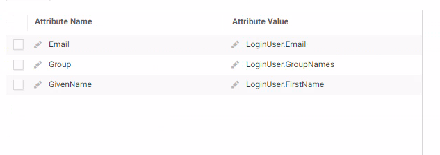

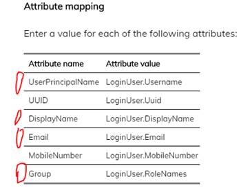

To integrate Centrify with ArcGIS Portal, we not only need config ArcGIS Portal, but also need config the attribute mapping in Centrify. If you want your Portal Group could integrate with SAML group, you have to pass the group attribute from Centrify response. The important mapping as below.

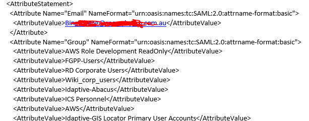

Once you have the above attribute mapping, you could check the response which would similar as below.

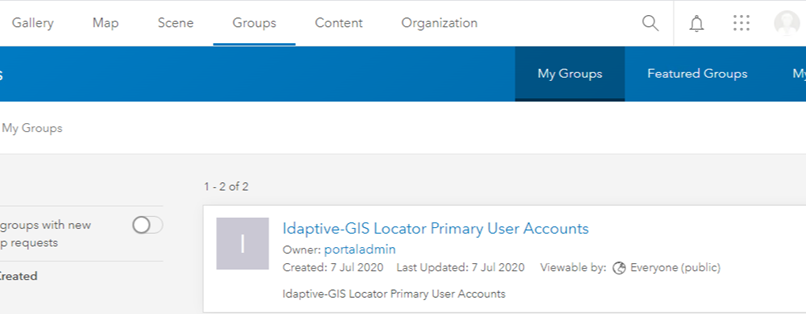

Once your ArcGIS Group integrates with the SAML group, you could find the SAML group from “My group” if you are a member of it.

When configuring the response Centrify sends to ArcGIS when a User authenticates,  Centrify administrator is able to map the internal attribute names (e.g. LoginUser.Email) to the"attributes" in the response (e.g. Email in your example).
In Centrify's case, you need to check which of the inbuilt attributes are suitable to map to the "Groups" attribute in the response. As you show, there are two potential candidate attributes LoginUser.RoleNames or LoginUser.GroupNames - for your site, you chose GroupNames but this may be different at other sites.
