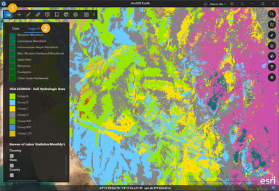

In ArcGIS Earth,  legend can be found at Table of Contents (No.2).  If the Table of Content is not expanded,  please click the button at the top-left corner (No.1)

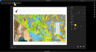

Since version V1.17,  we also introduced Export current view on a Layout,  then users can add the legend to the layout.
Try it and feel free to share your feedback.
