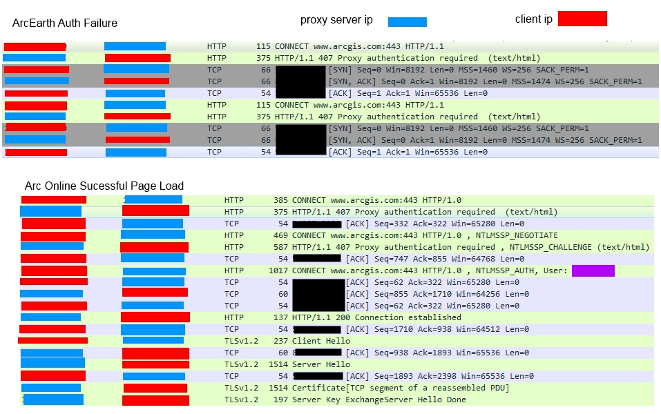

ArcEarth 1.4 does not appear to support NTLM proxy authentication, which is an issue which we encountered with previous versions as well. After launching AE on a computer with correctly configured system level internet options, two error messages appear:
"Failed to use proxy: the credentials are invalid Unable to connect to the remote server"
"The Remote server returned an error (407) Proxy Authentication Required"
Manually configuring the correct proxy server (using IP or hostname), username (with and without domain suffix) and password results in the same errors.  Overwriting the config.xml file in the AppData/Roaming folder or the Program Files/ArcGIS/Earth/Bin folders does not change the outcome.
The sign-on window for ArcGIS online loads and is able to navigate the proxy, but it appears to use Internet Explorer so that's not surprising. ArcEarth itself does not login, displaying the two errors listed above after "Sign In" is clicked.
Analysis of packet traffic suggests that ArcEarth might not be correctly responding to the proxy server's notification that NTLM is required. Compare the packet traffic shown below:ArcEarth proxy packet traffic

Our proxy server logging indicates that attempts are being made to contact it, and when incorrect passwords are entered in the config, no bad password attempts are logged. Examination of Wireshark packet logging indicates that the problem documented in the original post still exists, when the proxy server responds with 407 proxy authentication required, ArcEarth retries the connection without the NTLMSSP_NEGOTIATE flag.
