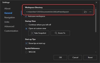

  1. Locate your workspace folder. The workspace location can be checked in Settings within ArcGIS Earth.
  2. Navigate to the following path inside the workspace:
    data\my_drawings.kmz
  3. Delete the my_drawings.kmz file.
  4. Restart ArcGIS Earth.
After restarting, ArcGIS Earth should automatically recreate the My Drawings file, which may restore the drawing functionality.
