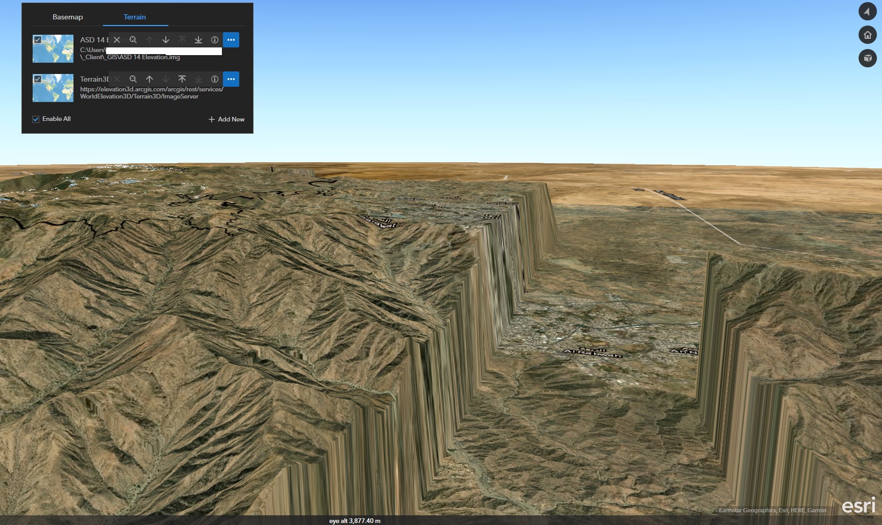

Hi, I've been trying to add some more detailed 10 m resolution DEM (as a IMG file stored locally on my machine). I'm adding that as a Terrain source, sitting above the Esri global elevation layer. However despite both data sources being set to visible, the Esri source does not appear when I got my own DEM switched on (creating a very steep cliff and flat earth!).
Any idea what I'm doing wrong?
Bruno
Terrain missing!

Hi Bruno,
Thanks for your feedback.
Earth displays terrain according to the order of your terrain sources panel. There is a bad interpretation of no-data cells in a local raster. It does not render well when the LoD change of the Esri global elevation layer.
We will let you know when this issue is fixed.
