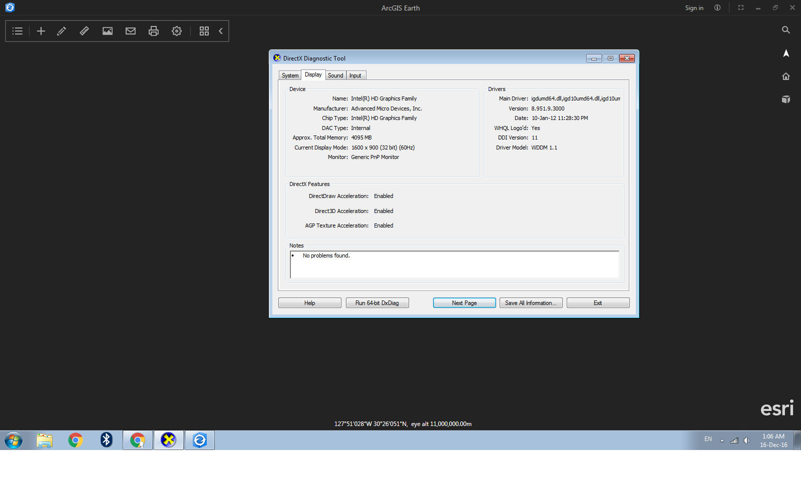

raedghazawi
Deactivated User
i have the same problem ,,, and my laptop specification is supported ,
