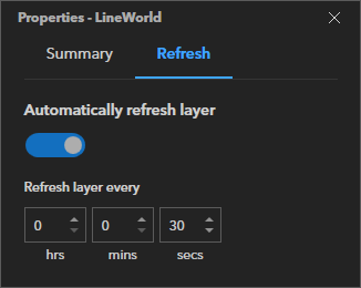

Hi @EmrahAydemir ,
Thank you for sharing your feedback. Currently, we support refreshing feature layers in two scenarios:
  • Setting a refresh interval in the layer properties, with a minimum interval of 30 seconds.
  • Events that trigger layer loading, such as zooming in or out, can also refresh the layer.
If you've tried these methods and the layers are still not refreshing as expected, providing more information, such as test data, steps to reproduce the issue, or a screen recording, would greatly help us identify the problem more accurately.
