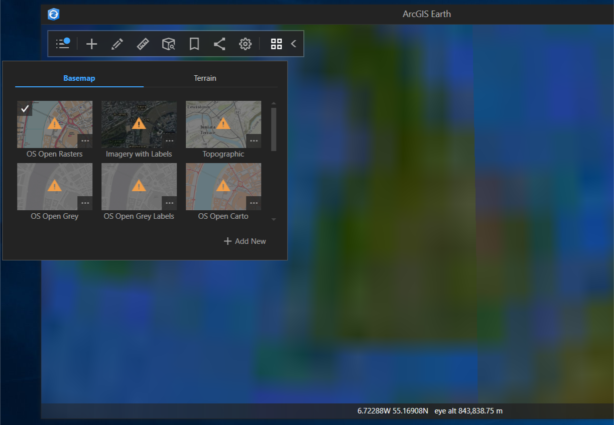

Is ArcGis Earth 1.8 still free? I'm not logged in and none of the base maps are available. Do you have to be logged in to access the maps? Does being logged in imply you need a paid account?

Ok, but even after I login all the base maps have a yellow triangle and cannot be selected (which is the same if I don't login). And the initial globe image is very blocky...that's the UK in the image below! Google earth is SO much better resolution! What's going on?

From the screenshot, I think you have set the spatial reference of Earth as WGS84? Please try to go Settings > General > Spatial Reference to select Web Mercator and restart Earth to have a look.
Most of the online basemaps are ArcGIS Rest Services, you can get the spatial reference from the Spatial Reference parameter of the service. For World_Imagery (MapServer), its spatial reference is Web Mercator(102100/3857). Please make sure the spatial reference of Earth meets to the spatial reference of services, so that you can have the data rendered well.

Thx to Xuewen, you were right, that fixed my problem
