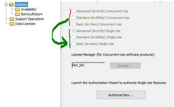

Hi,
Open you ArcGis Administrator and have a look at the Desktop Tab.
You have  the license set on Concurrent (instead of Single).
Did you get a License Number for authorizing your software?
If so, switch to Single Use, then "Authorize Now" and go through the authorization process.
For you to be able to switch from concurrent to single you have to Run the ArcGIS  Administrator as Administrator.
Authorizing ArcGIS single use products and features—Help | ArcGIS Desktop
Attached an example (Single Use)
PS. in the picture below you are not able to change the licence because the options are greyed out (I quikly opened the Arcgis Administrator without admin rights.)
If you run as administrator you will be able to change that.
