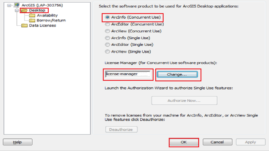

Not sure why I am receiving this message but would like to try to just add a spreadsheet of many points to desktop version, do you know of any data point limits on desktop version? I want to upload about 150k data points.

If you have authorized a Concurrent Use License, open ArcGIS Administrator > Choose appropriate license > Define the license manager (hostname). In case, the license manager is hosted in the same machine, you could define "LOCALHOST" as the license manager.
