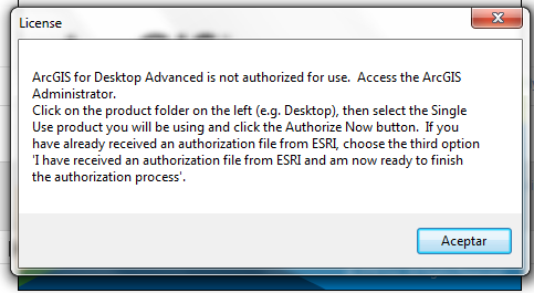

Hello,
Thank you for your response. I did try the online verification option too. I followed all the steps in the link and the same error.

Claudia,
Hmmm,  so you made a note of the EVA123456789 assigned to you when signing up for the trial.  Or you should have received the code in an email to valid email account you associated with your Esri user account, but that has been hit or miss for folks.
Then when you enter that exact EVA code, while running the authorization wizard--from ArcGIS Administrator --> Desktop with radio button selecting a Single Use, Advanced (ArcInfo) seat-- if you select the "authorize now via the internet", your system should exchnage TLS (https) packets with Esri Redlands servers.
You'll need to be connected to the internet and not have any firewall blocking https packetsTCP port 443.  Might need to disable your firewall or allow a firewall exception for--C:\Program Files (x86)\Common Files\ArcGIS\bin\SoftwareAuthorization.exe
An anti-virus could be interfering, Avast and AVG have had problems here for folks.
If all good, about 15 "exchanges" one for each component being authorized/activated.  At the end of that exchange you should see an authorization completion notice.
