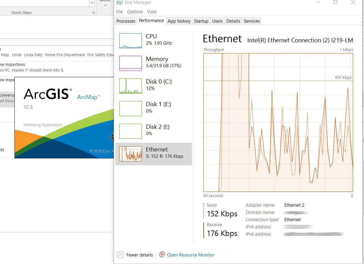

I'm running 10.5, new install on windows 10, i7 processor, 32 gigs ram and it just took me 3 minutes and 38.72 seconds to get Arcmap to where I could choose a map to open.
We're running Kaspersky, so we're going to ask our IT department for assistance on that.
But look at the attached image. This is my network usage going crazy while Arcmap is loading.
Perhaps it's not only Kasperky, but also Arc Connection (which I do not use, and wish would not automatically come on when Arcmap comes on, rather give me a button to click if I need the connection, ESRI, thank you?) which causes the problem?
Over three minutes. QGis is on in seconds at my house on my rinky dinky little old Lenovo...Net usage spike as Arcmap 10.5 loads

I've performed everything here that a non admin can do and nothing has helped. I have opened task manager and clicked arc connect and ended that task, and it didn't make any difference.
The reason I have this machine is so Arcmap would run faster.
Oh well.

Bill, honestly, I would check with Esri support. Three minutes is too long for ArcMap to load (at least after first time load, when a lot of user setup is required). I heard a great talk from a few support-niks with lots of good suggestions of things to try at EsriUC in the tech support theater.  You may have some display adapter issues that possibly could be tracked down with some help from Esri Support, they have some really nifty tools. I hear you about not having enough access to your computer to even do diagnostics.
