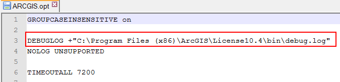

In order to record usage for ESRI, your ArcGIS License Server Administrator will need a debug.log.  You will need to specify it's creation in the ArcGIS.opt file.
In the JTB Core Configurator, you will need to specify the location of the debug.log in the Flexnet tab.

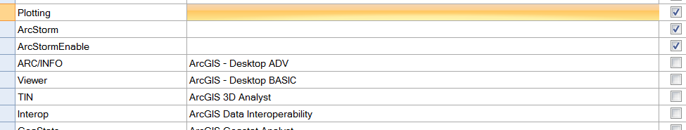

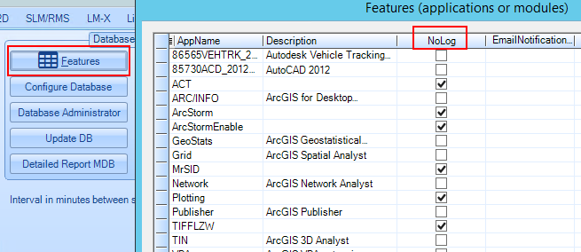

Also in the Core Configurator, set up the features and Descriptions of products you want to log.  You can select products that you do not want to log.  I would recommend not logging ACT, ArcStorm, ArcStormEnable, MrSID and TIFFLZW features.  These are all part of the ARC/INFO feature (Desktop Advanced) and will clutter the database.

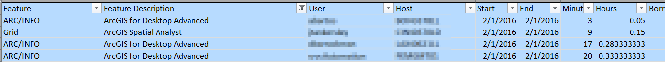

We also need to report usage by department level.  I haven't found a way to split up the user base by department in JTB itself.  But I can run a raw data report of all users and their product time.  Then using vlookup and an employee table in Excel, I can match the user login with their department.
