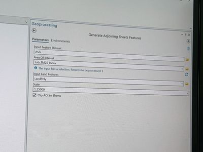

2. What happens if you execute Generate Adjoining Sheets Features GP tool? How many features are generated in the ASG_SHEETS_A feature class?
When I execute the Generate Adjoining Sheets Features GP tool, nine features are created.

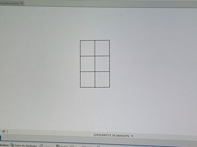

I think the main issue is related with the ASG_Sheets_L feature dataset, as there are clear differences made.
When I run the Generate Adjoining Sheets Guide GP tool outside of the EPM (workflow), all lines are created correctly to show 9 indexes.
However, when Generate Product step is completed through the EPM - cartography workflow, the lines are just drawn to show 6 indexes, and this is different by which index I selected.
I want to have 9 indexes regardless of the selection to the index in EPM. 

p.s. I found there is a Input Land Features in the Generate Adjoining Sheets Features GP tool. Do you think it's related with this issue? Because, for EPM, I don't think I have set any parameter for the land features as the production type.
