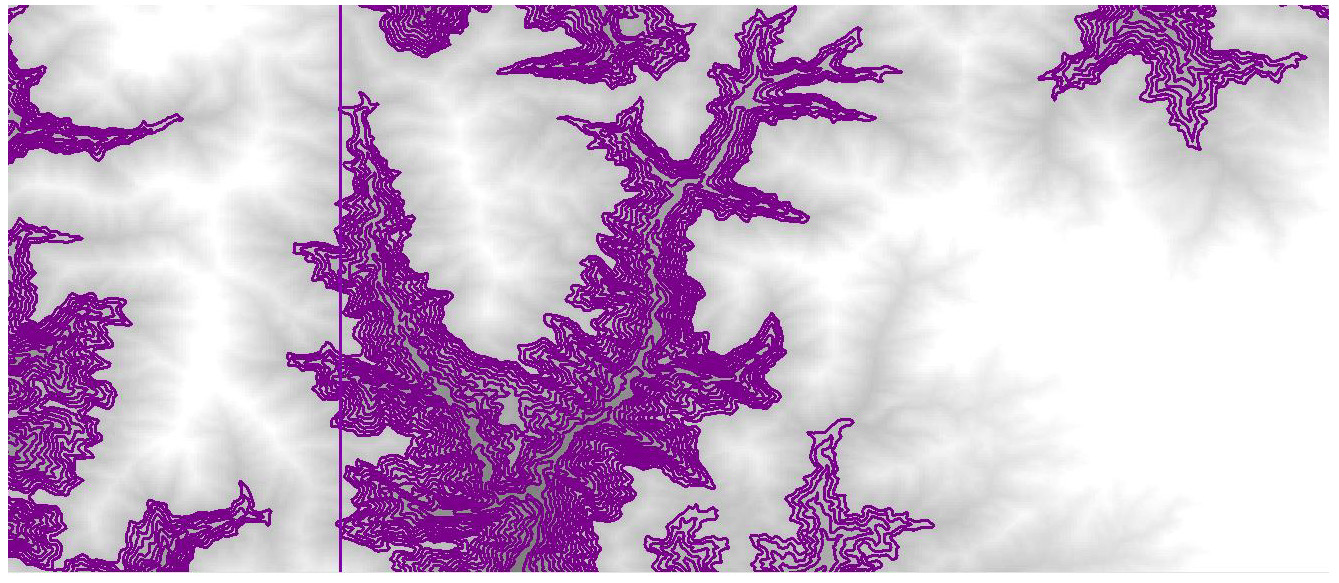

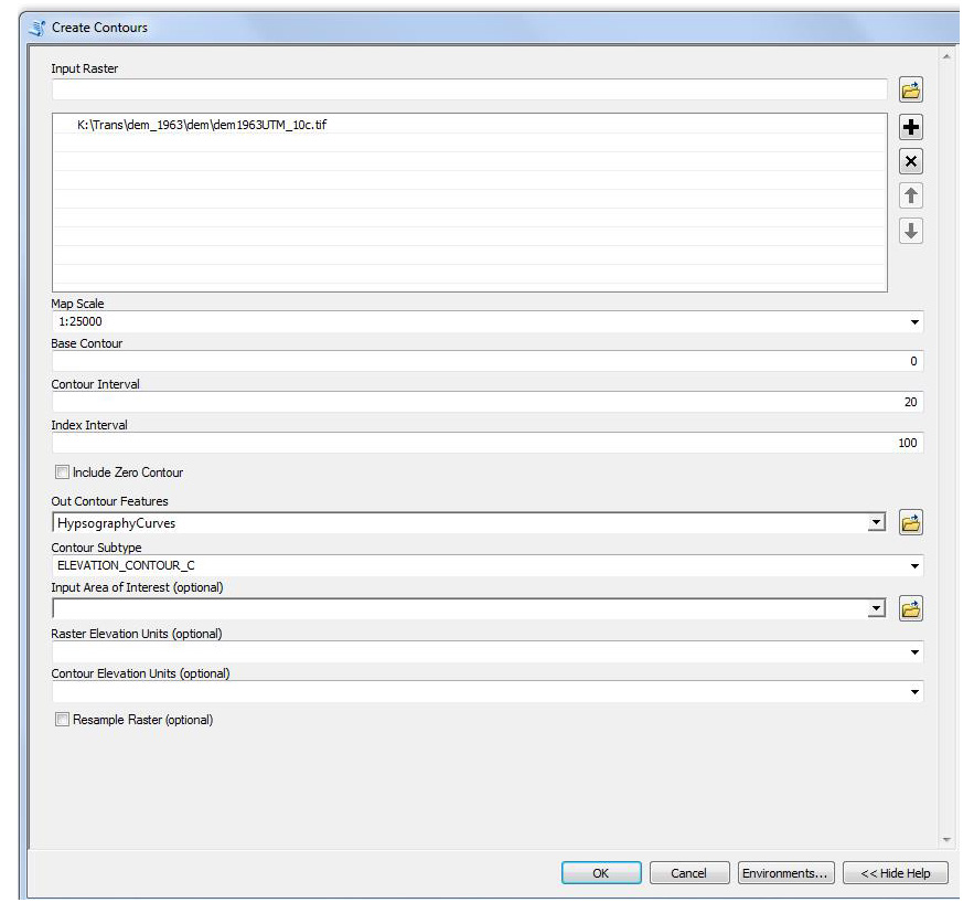

I have a DTM with cel size 10 x 10. I am trying to create contours for scale 1:25000 using the tool on Defense Mapping
Create contours.
I have insert parameters as seen below...
The results that i get includes only contours from 20m - 900m height.
But in DTM i have elevation up to 1940m. Why this information has been lost. Where is the problem? Should I resample my raster again and if yes what is the best cell cize for resampling for the above scale?
Above is the result with the gap of contours areas
Thanks
Argyro

try a different scale, your contours are really crowded now
argyroargyrou1
I tryed a different scale but still no big changes...

Hi Argyro,
Can you please try the following:
1. For the Raster Elevation Units parameter, specify Meters.
2. For the Contour Elevation Units parameter, specify Meters.
3. For the Resample Raster parameter, make sure it is checked.
What happens?
Regards,
Dan
