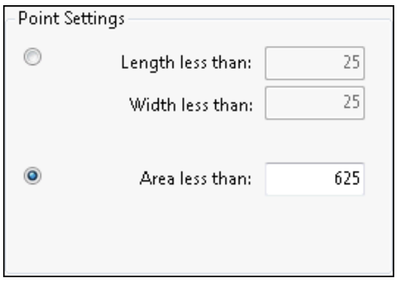

I want to use the point settings for making the areas larger than specific extent to points.

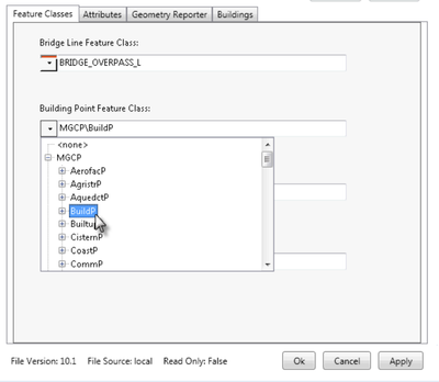

I used to do this in ArcMap by
1. Defense Mapping Toolbar > Options
2. Property Configuration > Feature Classes > Building Point Feature Class
3. Point Settings > Area less than ...
How can I do this in ArcGIS Pro?

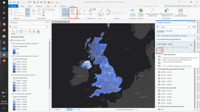

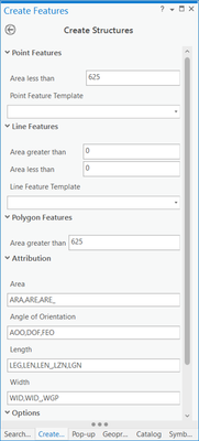

I believe now the way to do this in ArcGIS Pro is the create structures polygon construction tool available with the production or defence mapping license:
https://pro.arcgis.com/en/pro-app/latest/help/production/production-mapping/create-structures.htm,
It looks like this within ArcGIS Pro:
Create Features button to open the create features pane, then we should see it on the left if we have the correct licensing (highlighted in small red box)Create Features button to open the create features pane, then we should see it on the left if we have the correct licensing (highlighted in small red box)after clicking on the create structures construction toolafter clicking on the create structures construction tool
Let me know if that helps,
Kind regards
Keiran

Hi Keiran,
Thanks for the reply! It works very well 🙂
Thanks again.
