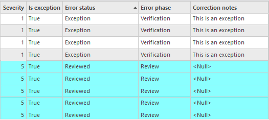

Working in Pro 3.4, I have a collection of Attribute Rule Validations. Some, when I "Mark Exception" also automatically update "Error status", "Error phase" & "Correction notes". But there is a set of rules that only "Is exceptions" updates. The only difference I can see between the validations is that the non-updating ones are Severity 5. Whereas the rules that auto-update error status are Severity 1.
Any idea why the error lifecycle information doesnt update?

All of the rules I cited above are "Ready to Use Rules" executed as Attribute Rule validations (Feature on Feature). I have discovered that the errors that don't automatically advance phase/status when flagged as exceptions are "composite" rules. So I feel better knowing there's some commonality/sanity to the behavior.

I was able to reproduce this behavior using ArcGIS Pro 3.4 and ArcGIS Enterprise 11.4 with error features created using the Composite check. The development team has logged an internal bug to address the issue.
I would suggest starting a technical support case (and log a bug) if you'd like to track progress and be notified when the issue is addressed.
