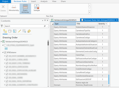

These are not attribute rules, but map-level Reviewer rules:
As much as I search for information, I see that these rules cannot be exported and that they would have to be created again using attribute rules. Is that correct?
Thanks.
Jaime.
JayCary
Thanks-much for the clarification on the type of Reviewer rules your customer has implemented.
Unfortunately, Reviewer map rules were deprecated at the ArcGIS Pro 3.0 release and there is not an automated method for exporting them to attribute rules. The rules would need to be re-created manually using the Attribute rules view (or imported from a Reviewer Batch Job if they had a similar implementation in ArcMap).
