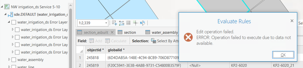

Evaluate Rules: Edit Operation Failed: ERROR: Operation failed to execute due to data not available.
3537
05-11-2023 09:34 AM
NathanWestby
We are on 2.9.5 and have Data Reviewer SOE installed and Data Reviewer license.
We are using branch versioning
We have a set of attribute rules for calculations, constraints, and validation.
We are creating a new map from a published feature service that was shared to our portal with Validation and Versioning checked, and error tables included.
When I Edit > Error Inspector > Evaluate Rules I constantly run into this error.
I've tried with both leaving the current version as the default version, as well as with switching to a branch version that I created for my version edits.
Any thoughts on what is causing our data not available? I checked every feature in this map has data in it's attribute tables.

NathanWestby
Your point #1 may be my issue. Does this apply for constraint rules as well? we published to feature services to our portal and I think I have rules from one web layer referencing features published in the other web layer shared.
