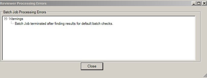

I am trying to help my team transition into using the ArcGIS Data Reviewer for QC processes. I'm a little frustrated because I am getting the following error message. It states that results have been identified, yet none of them are written to the table. Has anyone encountered this or know how I can resolve the issue? Many thanks.

Hi Anthony,
If default checks finds any error in your data then you will see this error, however if you select an option in the Reviewer Methods tab in Reviewer Session Manager to continue batch processing if default checks return error then your results are written to the Reviewer table. Please refer to the following link for more details about Default checks and Reviewer Methods.
Please let us know if you have any other questions related to Data Reviewer.
