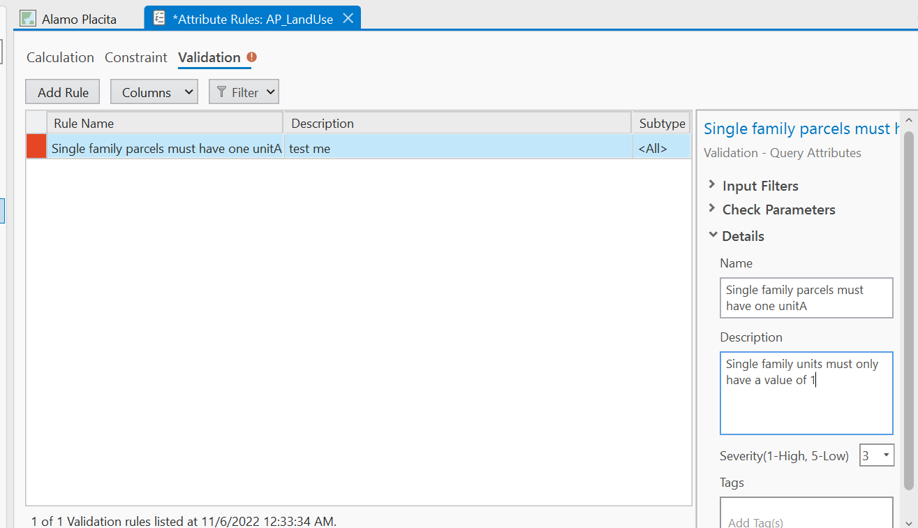

I'm trying to applying create validation rule using ArcGIS Pro 3 and following the Managing Data Quality Using ArcGIS Data Reviewer  training exercise
when click  save  , no any response and there exclamation mark  next to Validation
in addition when trying apply validation (feature on feature )
the feature to compare dropdown list and spatial relationship  empty
could you please help ,,

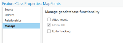

Have you enabled Global IDs on your AP_LandUse feature class? If not, in the Catalog Pane, right-click the feature class and click manage. In the popup, click manage, then check off Global IDs.
In the picture above, I previously enabled Global IDs, so it is now locked.
I get the same exact behavior you described if I have not yet enabled this option. Esri documentation does mention you need to do this, but it does not make that clear within Pro.
