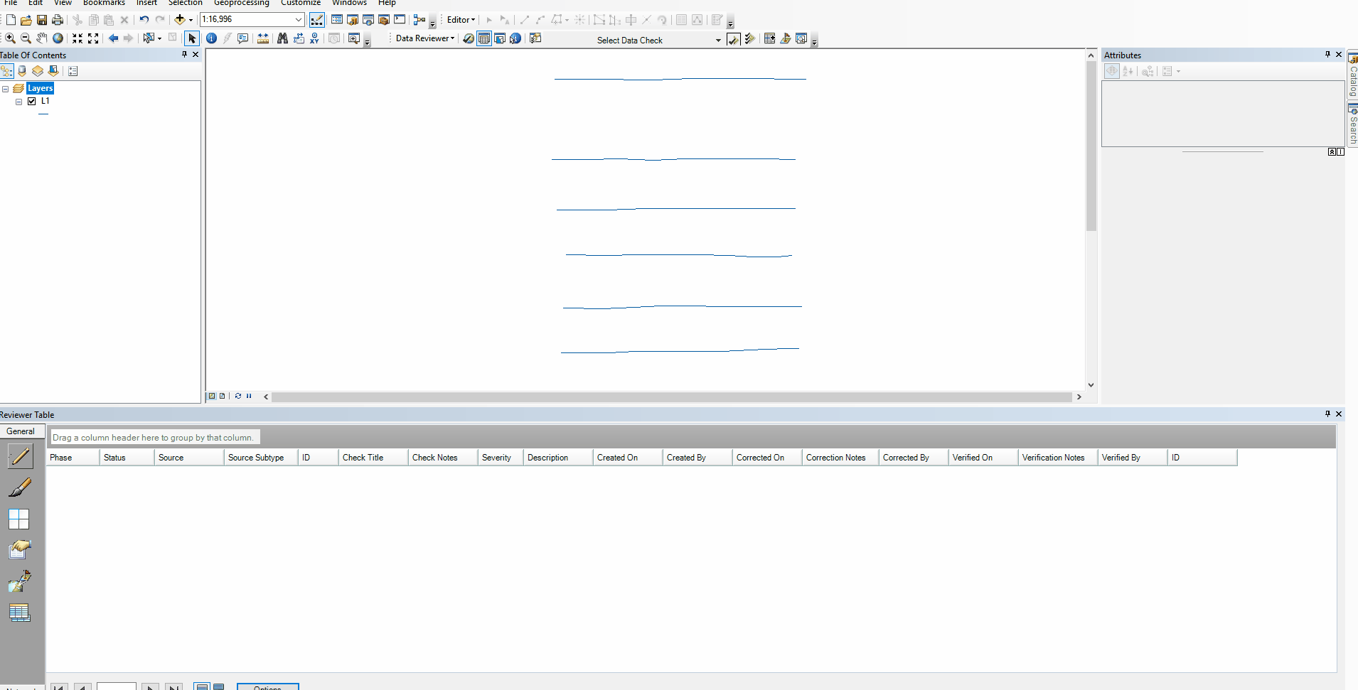

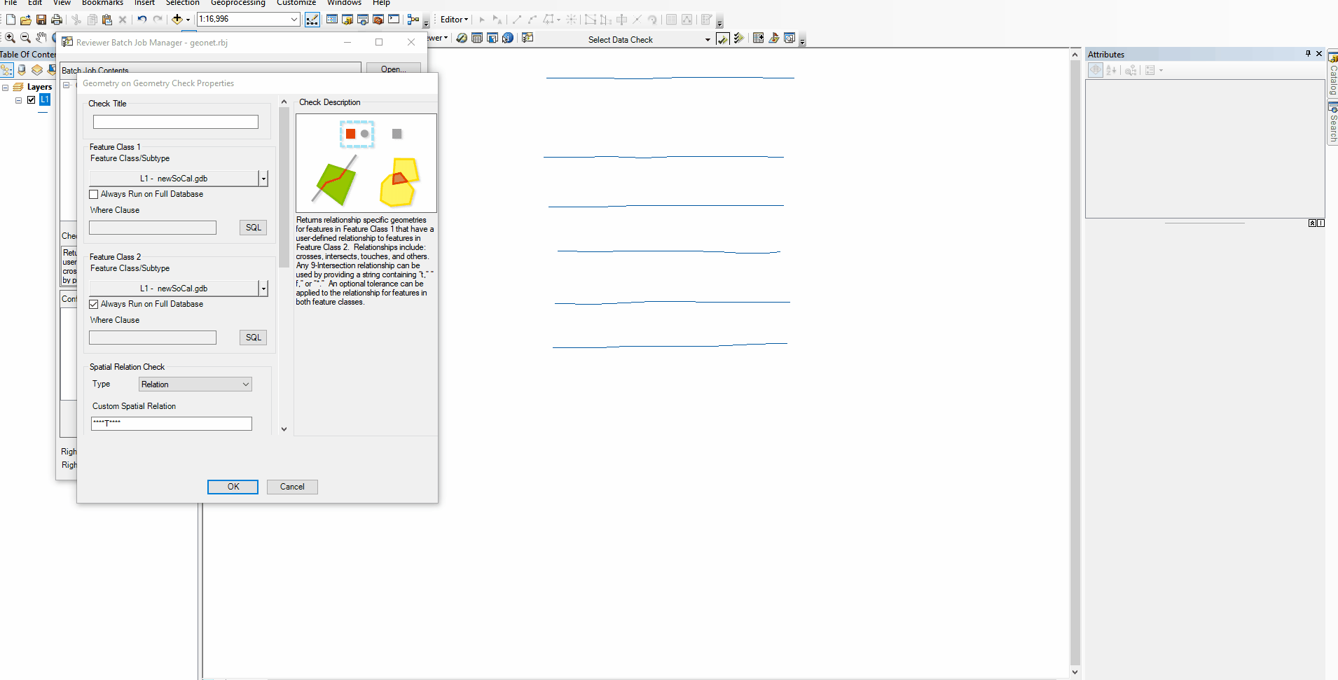

I quickly tested the scenario you mentioned with a sample data in ArcMap 10.7.1 but I am getting expected results, please refer to the video showing the workflow:
However, I don't see a value in using the "Always Run on Full Database" option if you are planning to use a Definition Query and same feature class a secondary.
About the Update you mentioned that you are only seeing this issue when you run it multiple times, I also tried that scenario, but I am not able to reproduce that as well. Please refer to the video below to see that workflow:
It seems this issue is specific to your Data, I would suggest you to please contact Esri Technical Support so that they can work with you to further troubleshoot this issue.
