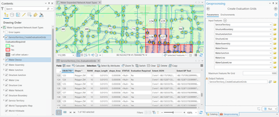

When the tool completes, it adds an Evaluation Required field and extent information fields to the generated partitions, applies symbology, and adds the resulting layer to the active map.

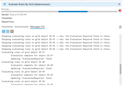

As the tool runs, a geoprocessing message is added after each polygon grid is evaluated, indicating whether the grid was processed or skipped. This makes it easier to track progress during long-running evaluations.

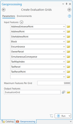

First, run the Create Evaluation Grids tool to create the grid that the Evaluate Rules By Grid tool will use. To do so, complete the following steps:
  1. In ArcGIS Pro, add all feature layers that contain validation attribute rules to a map
  2. Add the GridEvaluation.pyt toolbox to a project
  3. Click on Create Evaluation Grids
  4. For Input Features, select the feature layers that contain validation attribute rules
  5. Set the Maximum Features Per Grid parameter
  6. Set the output location
    1. Outputs can be placed in file, mobile, or enterprise geodatabases.
    2. The output will be in WGS 1984, so if placing the output in a feature dataset, it must be in WGS 1984.
  7. Run the tool

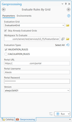

Next run the Evaluate Rules By Grid tool
  1. Open the tool and for Evaluation Grid, select the grid output from the Create Evaluation Grids run
  2. Keep Skip Already Evaluated Grids checked
  3. For Workspace to Evaluate, select the file, mobile, or feature service to evaluate attribute rules on
    1. If the workspace is a feature service URL, additional parameters will appear
      1. Fill out the Portal URL, Portal Username, and Portal Password for the enterprise user that will be running the evaluation.
      2. Specify the version to run evaluation on.
        1. Please note that this field will automatically be populated with a dropdown list of available versions once the portal information is specified. This may take a minute.
  4. Set the Evaluation Type
  5. Run the tool
    1. While the tool is running you can view the messages. This will tell you which grid polygons have been evaluated and which were skipped (if any).
