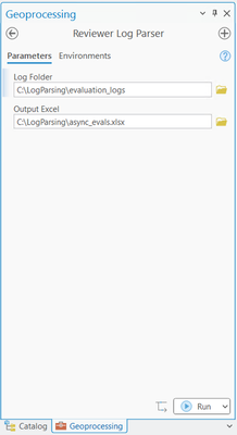

  4. Run the tool in ArcGIS Pro or from the terminal.
    1. To run the tool in ArcGIS Pro
      1. Save the ReviewerLogParser.pyt file to a known location
      2. Copy all of the server logs to the machine with ArcGIS Pro
      3. Open ArcGIS Pro and add the toolbox to a project
      4. Open the Reviewer Log Parser tool
      5. For the Log Folder parameter, browse to the folder containing the server logs and click OK
      6. Specify where to place the parsed excel output
      7. Run the tool

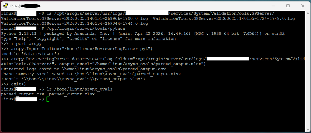

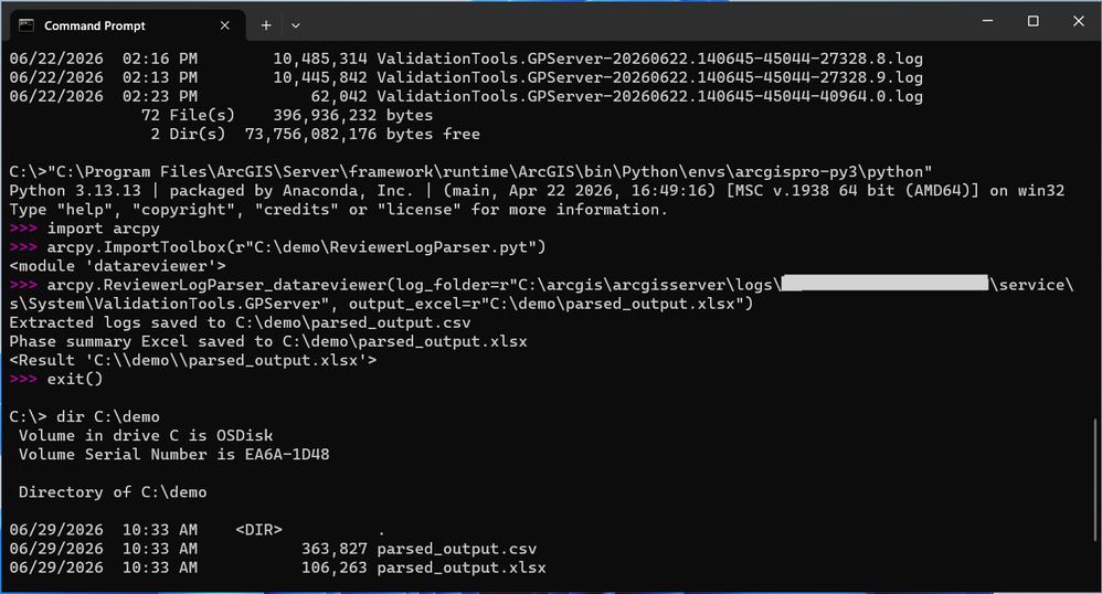

    2. To run the tool in the terminal via the python interactive shell on the server machine with the logs:
      1. Save the ReviewerLogParser.pyt file to a known location on the server machine
      2. Identify the server log location
      3. Launch the interactive python shell tied to ArcGIS Enterprise
        1. For Windows it is typically "C:\Program Files\ArcGIS\Server\framework\runtime\ArcGIS\bin\Python\envs\arcgispro-py3\python"
        2. For Linux it is typically <ArcGIS Server installation location>/arcgis/server/tools/python
      4. Import arcpy
      5. Import the toolbox
        1. arcpy.ImportToolbox(path/to/ReviewerLogParser.pyt)
      6. Run the tool
        1. arcpy.ReviewerLogParser_datareviewer(log_folder="/path/to/log/folder",output_excel="/output/excel/parsed_output.xlsx")
      7. Copy the output .xlsx and .csv to a machine that has Microsoft Excel (or an Excel viewer) installed and view the results.
