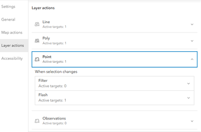

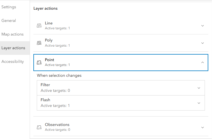

As per my understanding, it depends on the source element. Please refer to the documentation below.
Configure actions for elements—ArcGIS Dashboards | Documentation
Zoom is not a supported action from layer actions. You can use filter first and select only one object. If it has geometry, it will zoom to the selected or you can also try flash.

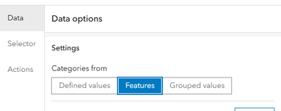

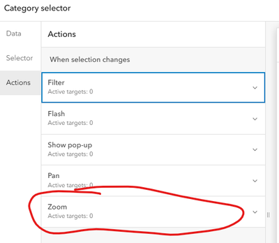

Just following up on what @VenkataKondepati said, You have to use a selector (or table/chart action) on a feature on the map and the category settings set to "features"
Then you get the Zoom Options
It will zoom on a single or multiple select.

@AmyAlford1 It appears it needs to be a direct select and not a relationship.  e.g.  Select a county, zoom to county.
