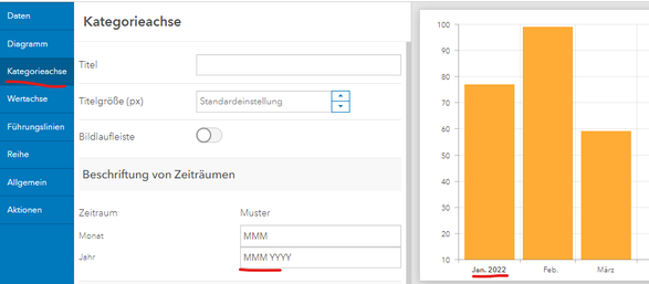

Hi everybody. I have an issue with dashboard's serial chart. I can't parse the date correctly. The data I want to use has its date column (datatype is date). When filtering everything looks normal in map but when it comes to use the data in dashboard serial chart, the first month of the year (January, 2022) looks like " the year ". I've attached a png file so you can check yourself too. I don't know how to solve this problem. I know there is something wrong with the data but don't know where to start. Does anyone have any idea?

There is nothing wrong with the data, it's just how the serial chart works. You can change how the year is displayed in the category axis parameters:

Thank you @JohannesLindner. It's so simple 🙂 and also so interesting that labeling works like that anyway. I changed it as I want.
