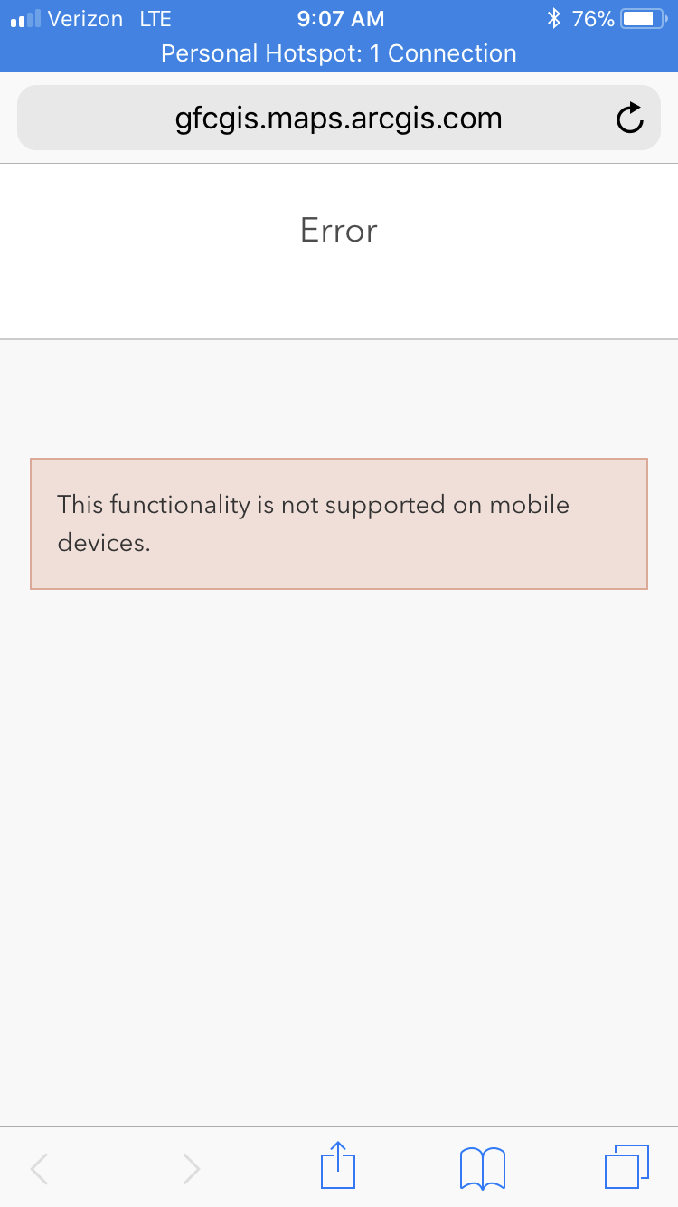

I created a dashboard through ArcGIS Online and shared it publicly. However, when I copy the share link and send to someone else (or myself), it shows up fine in windows but nothing displays on a phone or tablet. See below for the error message. I've tried this with both Android and IOS. I could not find any documentation stating that Operations Dashboard does not work with mobile devices. Does anyone know what's going on?
"Error, this functionality is not supported on mobile devices."

With the recent ArcGIS Online June 2018 update, dashboards can now be viewed on mobile phones. Please see this blog for details,
https://community.esri.com/community/gis/applications/operations-dashboard-for-arcgis/blog/2018/07/0...
Hope this helps,

Yes, but in a future ArcGIS Enterprise release; probably the 10.7 release. It is not available in the 10.6.1 release.
Hope this helps,
