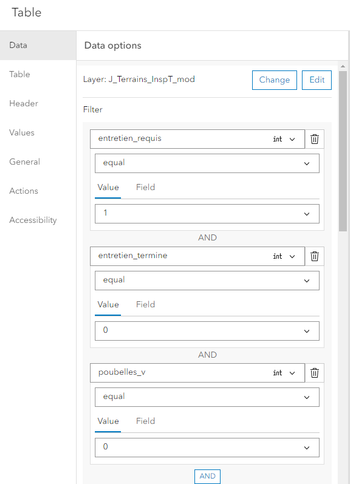

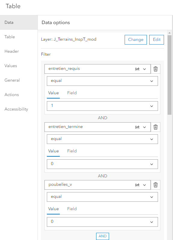

The easy way to do this would be like this: condition1 AND condition2 AND (condition3 or condition4 or condition5 or conditionX). But I can't seem to be able to achieve this in dashboards. The only way i found was:
(condition1 and condition2 and condition3) OR (condition1 and condition2 and condition4) OR (condition1 and condition2 and condition5) OR (and so on for every other OR condition)

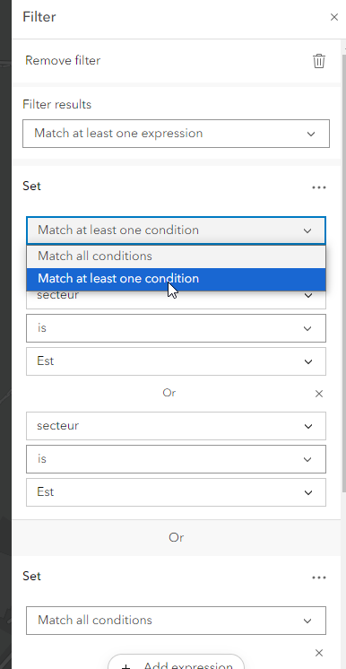

However, I know that you can better combine AND and OR in map viewer. Why not in dashbords?

Just to be clear, I'm talking about filtering data in a TABLE.

Yes the second type of statement solves my problem. However I must apply this condition for multiple fields, so it's rather long to do in the dashboards interface. Plus, everytime I edit my source (arcade expression), I have to start all over. I guess I'll do it in the JSON and then push it through the API.

In map viewer, you can change the "levels" of the filters, so you can have nested AND and/or OR.

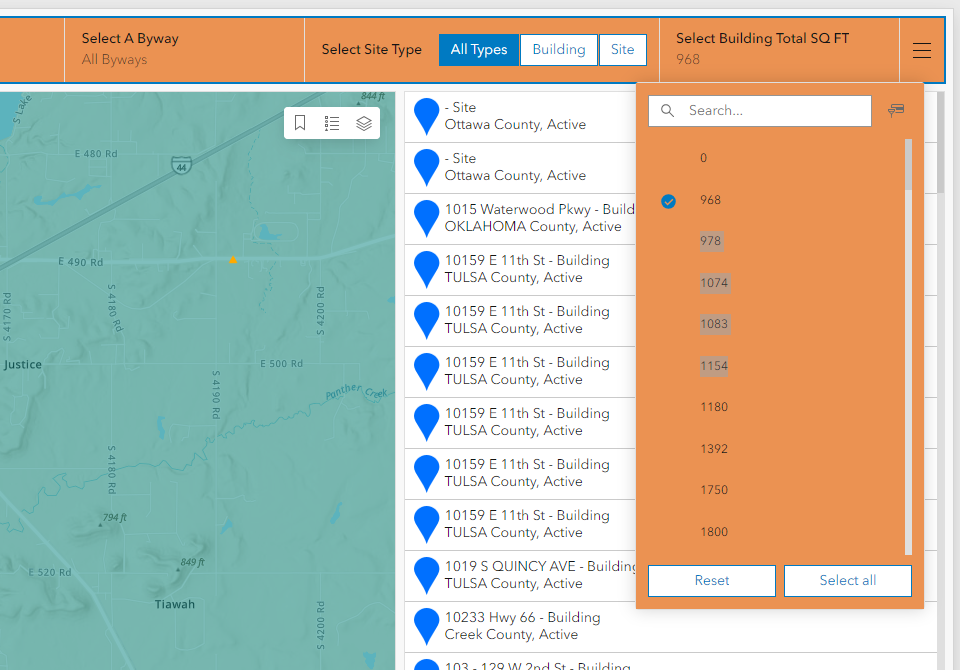

The best setup is supposed to let application's users DO THEIR OWN selection, not our own preset.  I managed to do some for my property's set for they to make choice of type, choice of total SQ FT, etc....  Well, it is OK to set for a few but if the selection choices are 4, 5 , quite a big mess on the header's bar
