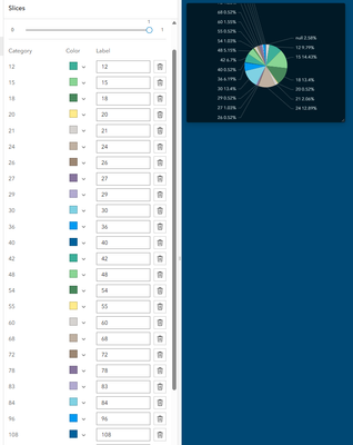

I want to make a pie chart for the sizes of culverts in my county. Instead of having one slice per number, is there a way to group the numbers into two groups: >60 and <60?

I think you made need to do a new data expression to categorize your culvert size. Something like this should get you started:
var portal = Portal('https://www.arcgis.com');
var feature_layer = FeatureSetByPortalItem(portal, 'xxxxxxxxxxxxxxxxxxxxx', x, ['CulvertSize']);
var Cultvert_Rankings = [];
for (var f in feature_layer) {
    var category = When(
        f.CulvertSize < 60, "<60",
         ">60"
    var Cultvert_Ranking = {
        attributes: {
            CulvertSize: f.CulvertSize,
            CulvertRanking: category
    Push(Cultvert_Rankings, Cultvert_Ranking);
var out_dict = {
    fields: [
        { name: "CulvertSize", type: "esriFieldTypeInteger" },
        { name: "CulvertRanking", type: "esriFieldTypeString" }
    geometryType: "",
    features: Cultvert_Rankings
return FeatureSet(Text(out_dict));
