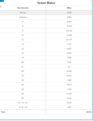

I am trying to make some Pivot Tables in Dashboard with Table widget.
there is a default options to toggle on row striping and it alternates the color of the rows:
However, if you choose Advanced Formatting for the values, the arcade overrides all the row striping, and I can't find any example/method to turn that back on with arcade.
Is this possible?  Any samples out there similar to this?

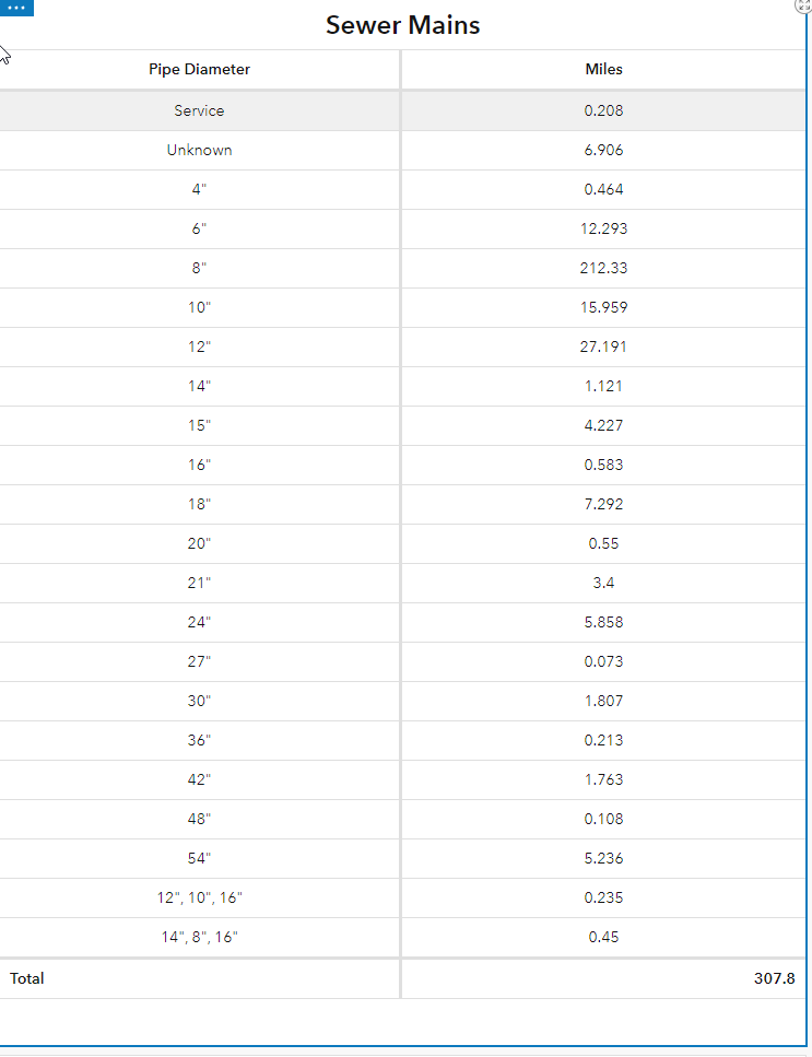

JerrySneary
Hi @Kepa ,
This is my code for row striping and it works but now I noticed that I can't do individual background cell color. Is there a way within the for loop to do individual cell color and row color?
var bgColor = When($rowindex %2 == 0, '#ffffff', '#F8F8F8');
for (var cell in row.cells) {
    row.cells[cell].backgroundColor = bgColor;
't

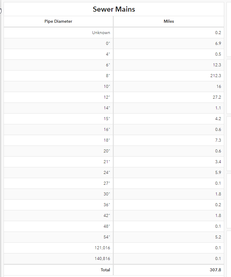

steven
Kepa's method is working only need to change the code a little bit.
create a variable color and in the code put color after backgroundColor like below:
  backgroundColorcolor,
please see my whole code example follow:
